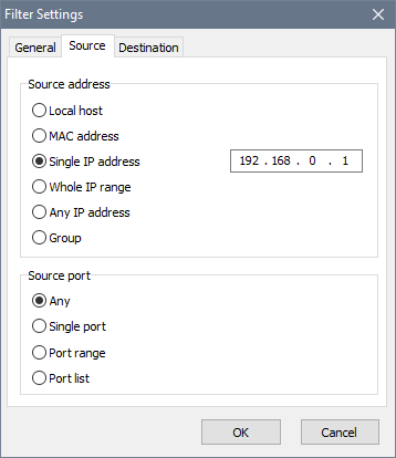

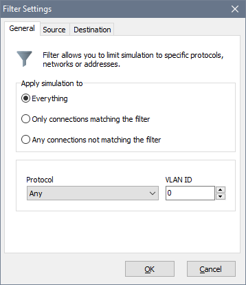

Setting up a filter
In order to restrict the simulation to a specific IP stream, you can define a filter. The filter compares the protocol field, the source and destination address fields in IP packets as well as source and destination ports in TCP/UDP packets to decide pass a packet or process it. Both IP protocol versions 4 and 6 are supported:
General filter settings
If you are running one or more virtual local area networks, you can also restrict the simulation to a particular VLAN:
Filter settings: restrict the simulation to a particular VLAN
